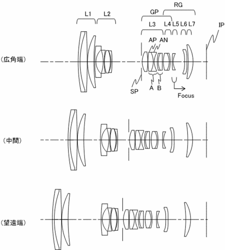

There are three embodiments that I’ll focus on because they start at 15mm, which, for Canon’s APS-C crop cameras, is, in my opinion, the optimum focal length for a normal zoom.
Canon RF-S 15-70mm f/4 IS STM
A constant f/4 zoom for Canon’s APS-C system is long overdue. Granted, it’s not the same as the Canon EF 17-55mm f/2.8, but starting at 15mm would be a delicious standard zoom, giving Canon’s APS-C users their 24-105mm equivalent focal length lens.
The lens does take a bit of a stretch hit at 15mm, which isn’t unusual for Canon’s RF non-L designs, but that cleans up before the midpoint of 36mm. The back focus distance of 10.46mm is pretty tight. I’m not sure if we’ve seen a production example of a lens that sits 9.5mm back into the lens mount on a Canon RF camera. The shutter assembly is usually quite close to the sensor plane, so I really don’t think this is a problem, but it’s certainly an extreme example of sitting inside the mount.
Wide AngleMiddleTelephoto
Focal length15.4536.0367.94
F-number4.124.124.12
Half angle of view (°)41.2719.5910.60
Image height12.6613.6613.66
Lens length100.14108.00120.23
Back Focus Distance10.4610.7912.37

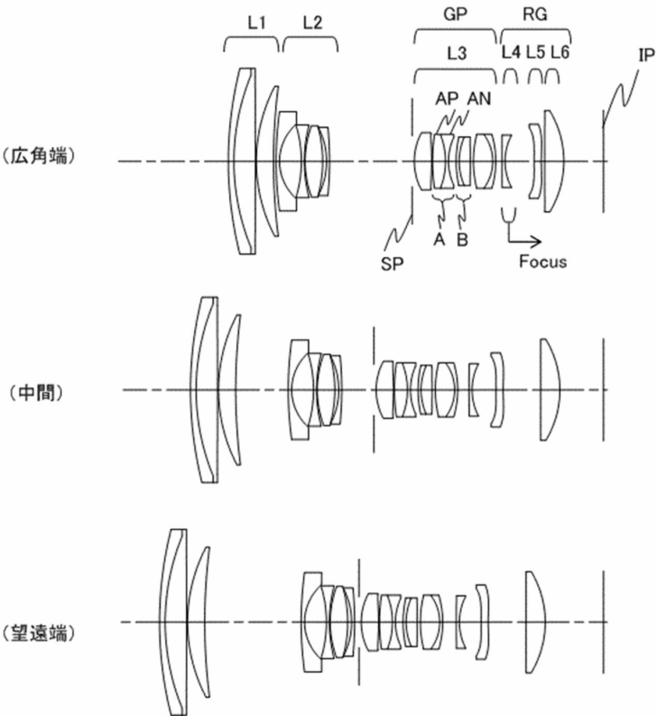

Canon RF-S 15-70mm f/2.8-4 IS STM
This design makes me go back and forth on whether or not I like the preceding design better or this one. Having a maximum aperture of f/2.8 on the wide end is extremely compelling, even if there is a gradual slowing down of the lens past the midpoint of 36mm.
This lens still needs some stretching at its wide angle, but that quickly disappears before the mid-point of the lens, where the image circle is the full size required for Canon’s APS-C sensors (13.66mm). This lens does have an odd movement, with the rear element starting off at 8.5mm inset into the mount, and then increasing to 10mm inset into the mount before moving back out at the telephoto end. This could make it a no-go as it sits even closer to the sensor plane than the preceding example.
Focal length15.4536.4768.05
F-number2.883.814.12
Half angle of view (°)41.2819.1710.42
Back Focus Distance 11.469.9813.02
