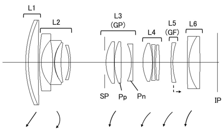

In this patent application, canon is doing something a little different, though; they want to use a large resin element at the business end of the lens, as that typically is the largest and thus heaviest element. However, with temperature changes, the focal position and aberrations can change – so Canon wants to arrange resin elements in a group to cancel out these changes in temperature effects.
Canon RF 24-50mm F2.8
| Wide Angle | Mid Range | Telephoto | |
| Focal Length | 24.70 | 36.56 | 48.80 |
| F-Number | 2.90 | 2.90 | 2.90 |
| Half Angle of View | 37.93 | 30.17 | 23.91 |
| Image Height | 19.25 | 21.25 | 21.64 |
| Lens Length | 127.00 | 135.58 | 146.40 |
| Back Focus Distance | 19.97 | 25.52 | 29.15 |

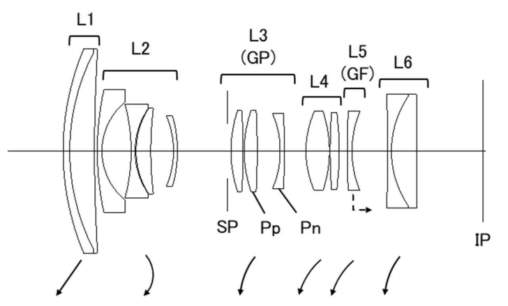

Canon RF 24-70mm F2.8
| Focal Length | 24.70 | 45.00 | 67.90 |
| Half Angle of View | 37.63 | 25.68 | 17.67 |
| Image Height | 19.04 | 21.64 | 21.64 |
| Lens Length | 141.13 | 155.45 | 173.50 |
| Back Focus Distance | 13.00 | 24.93 | 31.83 |

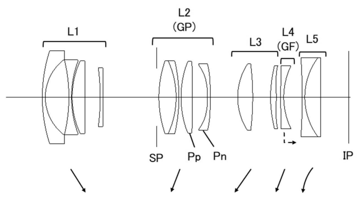

Canon RF 28-100mm F4
| Focal Length | 28.84 | 63.61 | 101.85 |
| F-Number | 4.12 | 4.12 | 4.12 |
| Half Angle of View | 33.94 | 18.78 | 11.99 |
| Image Height | 19.41 | 21.64 | 21.64 |
| Lens Length | 185.56 | 213.24 | 248.11 |
| Back Focus Distance | 19.76 | 22.67 | 23.79 |

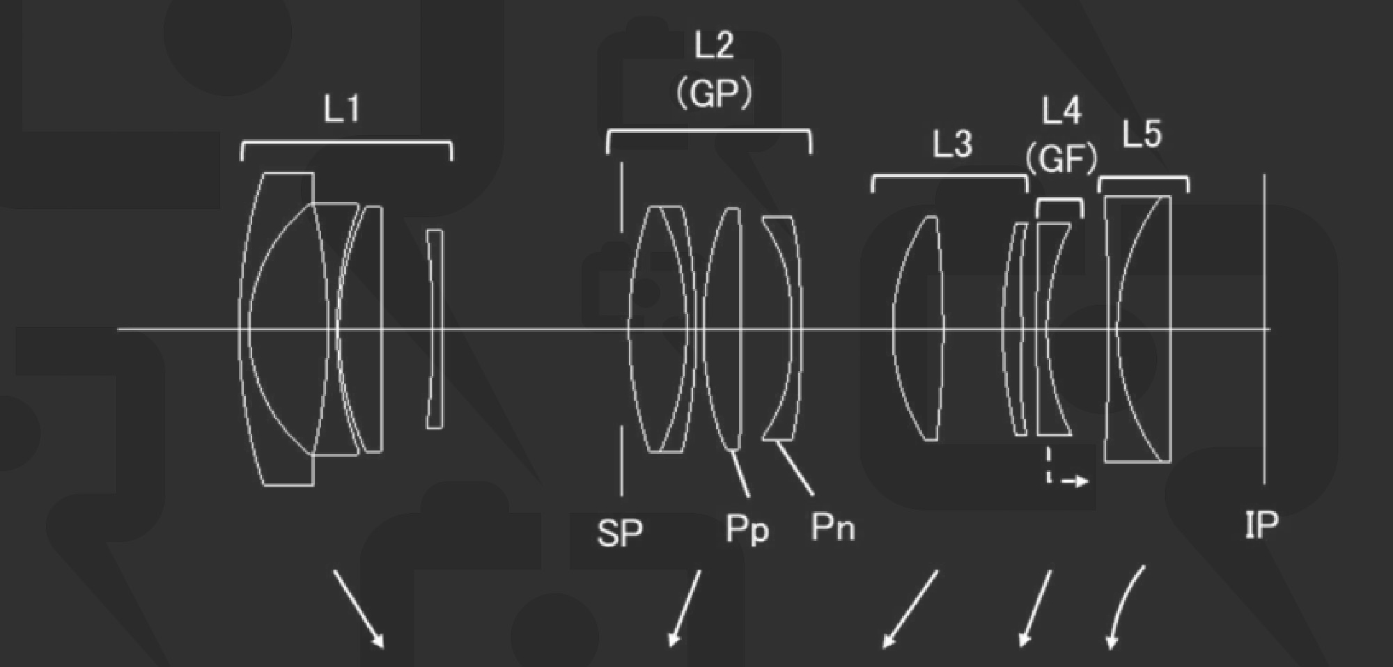

Canon RF 24-35mm F2.0
| Focal Length | 24.70 | 28.06 | 33.95 |
| F-Number | 2.06 | 2.06 | 2.06 |
| Half Angle of View | 37.63 | 35.20 | 31.36 |
| Image Height | 19.04 | 19.79 | 20.69 |
| Lens Length | 142.44 | 137.16 | 130.51 |
| Back Focus Distance | 13.00 | 16.72 | 18.74 |
Canon RF 24-35mm F3.5
| Focal Length | 24.70 | 28.14 | 33.95 |
| F-Number | 3.61 | 3.61 | 3.61 |
| Half Angle of View | 37.62 | 35.11 | 31.76 |
| Image Height | 19.04 | 19.79 | 21.02 |
| Lens Length | 117.52 | 112.99 | 107.27 |
| Back Focus Distance | 13.12 | 12.36 | 12.12 |
