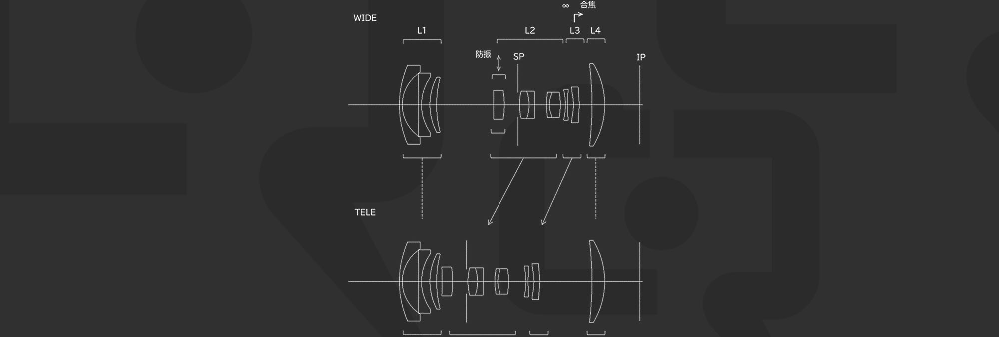

In this patent application (2024-076793), Canon shows off some embodiments of some lenses with internal zoom and focusing. The first embodiment that I'm going to talk about is a constant 60mm in lens length and a constant F4 aperture 12-30mm lens. The APS-C lens lineup hardly ever gets this kind of love, so it would be nice to see if Canon would do lenses like this.

Also in the patent application was a curious full frame (with a fair amount of image stretching) 20-40mm.

As with all Canon patent applications this may never end up in an actual product, but every now and then, we can dare to dream.
