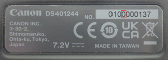

The Problem
Some parts of this product may consume battery power quickly when the power is turned off.
If a fully charged battery is inserted and the power is turned off, the battery may run out in about two days.
Check your serial number
The affected products are the “Speedlite EL-5” flash units with a “0” as the fourth digit from the left of their serial numbers and which are experiencing the above-mentioned issue.
The Solution
If the product in question exhibits this phenomenon, we will inspect and repair it free of charge. However, please note that there may be a charge for inspection and repair of the product in question for any other phenomena not mentioned above.
Canon will do these repairs until Until September 30, 2026.
Check with the Canon subsidiary in your country for the repair process. The repairs will take between 10 days and 2 weeks to be complete.

  1. Nice of them to finally acknowledge what some on this forum have experienced. I’ll check my serial number, but I suspect I’m not affected (my battery seems to hold charge fine).

  3. I have an affected serial number but have not experienced the issue at all. Routinely leave the full charged battery in the flash off in my bag and maybe in a week or two it just goes down 1 of the 4 bars, if at all.

  5. I have an affected serial number but have not experienced the issue at all. Routinely leave the full charged battery in the flash off in my bag and maybe in a week or two it just goes down 1 of the 4 bars, if at all.
    Yeah, turns out mine is ‘affected’ based on serial number, but like you I have no problems.

  10. I have an affected serial number but have not experienced the issue at all. Routinely leave the full charged battery in the flash off in my bag and maybe in a week or two it just goes down 1 of the 4 bars, if at all.
    Same here, the charge does drop to half after two to three weeks, but not drained to zero. If they offer free postages, I don't mind sending it back to get serviced.

  13. Looks like my less than a month old EL5 is also affected according to the serial. Now I’ll have to start keeping the battery inserted overnight to see if the unit is actually affected!

  15. I have an EL-5 also - couldn't resist it when Canon Refurb recently had them for $150. I like mine - color balance and TTL exposure are more accurate than my Godoxes (which I still use). Mine has the 4th digit 0 serial number, but so far does not exhibit the battery drain issue.

  16. I own a couple of these: they're in the recall range. I knew about the battery drain from the forums so I made sure to leave batteries in them to see. Resting, I lose about 1% or so a day (varies) which is what I'd expect from high discharge cells. As for Godox, I've used them and found them to be clunky (mostly the triggers) and produced banding in high speed sync. There is no panacea (just read the Godox forums). About the only thing that really impressed me were the Yonguo YN622C II transceivers: they worked fine. I'm hoping once all the EX gets out of the system Canon will address the wireless drop issue: the EL series are firmware upgradable via the camera body, so we'll see.

  17. I have four EL1 and two EL 5. No issues with any at all. Both my EL 5 flashes fit into the serial numbers mentioned but I have not experienced this. I use the EL 5 flashes on camera at receptions and the EL 1 flashes on stands mostly on 1/8 power so I don’t ask a lot of them haha. But the on camera are in TTL and I get a whole wedding and go home with half batter in my on camera and 3/4 left off camera. I do check the frequency band before each wedding at the venue and seldom see any misfires. Touch wood it stays this way haha.

  18. I guess this explains why when new, after leaving the supplied battery in the camera, it drained to zero and refused to charge. I've been using aftermarket batteries without issue in it; I check the flash periodically and it's always at full charge. I guess I'd like some more details on the problem.
