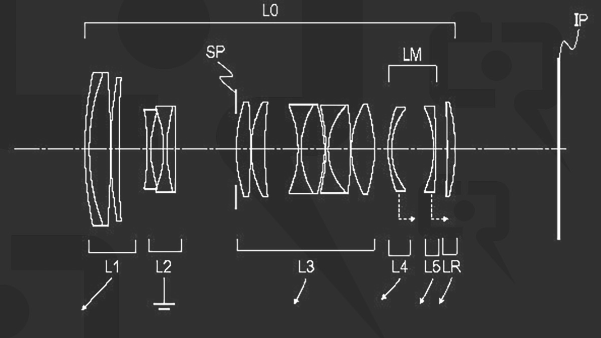

Super Telephoto Zooms
Canon had published two applications with the same design. In these two patent applications (2025-150145 and 2025-150157), Canon explores the 200-500 f/5.6 IS configuration.
Now this isn’t the first time we’ve seen a Canon RF 200-500mm F5.6L IS Patent application (or in this case, two patent applications), and I suspect it will not be the last. Will there be a lens that comes out of it? It’s hard to say, but it is undoubtedly a targeted focal range and aperture that Canon is spending a considerable amount of time researching. There is a massive gap between Canon’s 100-400 f/2.8L and the Canon RF 100-500 f/4.5-7.1L IS USM in terms of price, so there’s quite a bit of room for Canon to slide another fixed aperture zoom lens into the mix.
This is an internal zooming lens as the lens length does not change with focal length and is also teleextender friendly.

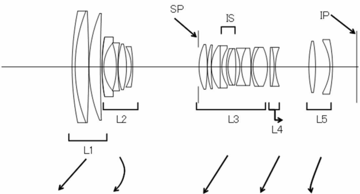

Compact Fast Zooms
In this patent application (2025-149060), several designs for a fast yet more compact zoom are presented, ultimately resulting in a 3x 50-150 mm zoom lens with a fixed f/2.8 aperture.
Canon RF 50-150mm F2.8
I know this is also a sweet spot for many APS-C users, and this may be a lens that serves a significant amount of use across both APS-C crop cameras and also full-frame cameras. The design looks fairly complex enough to warrant the “L” label, perhaps, but it could very well be a slightly under-L in terms of weather sealing and lens body, for instance, something like the Canon EF-S 17-55mm f/2.8. Just hopefully not as much of a dust magnet as that lens.
This is an external zoom lens with a 50-150mm focal length, suitable for full-frame cameras, and it is also teleextender-friendly. With a lens length of around 150mm, it would be very compact, and if you find yourself using the wide to middle focal lengths on the 70-200, this lens may be something you’d consider if Canon actually made it.
This feels like the theme this week is “Hey, this lens would be great for full frame and crop cameras – but would serve two different use cases.” I’m not sure if this is an actual thing that Canon is going to try to do, or just some random synapses running through Richard’s head, having to read too many patents lately.
