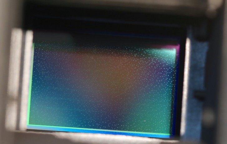

In some units of the models listed below, the following phenomenon may occur due to irregularities on an optical layer located in front of the image sensor:
White spots may exist on the optical layer which may result in the appearance of dark circular patterns on the captured image under certain shooting conditions.
