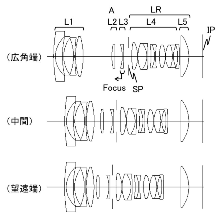

Now, back to this patent application (2024-101615), we see that the first embodiment is the Canon RF 16-28mm F2.8 IS STM (naturally, it is, just to rub it in, Canon). From embodiment 1, here's the optical formula and how the elements move as the lens zooms.

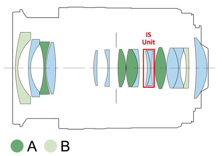

And just to confirm that this is the Canon RF 16-28, here's the published element layout.
But this allows us to garner more information than what the MTFs tell us, primarily how much of this performance is due to digital correction.
WideMiddleTelephoto
Focal length15.488 24.114 27.160
F-number2.900 2.900 2.900
Half angle (°)54.532 42.075 38.744
Image Height17.550 20.100 20.460
Lens Length140.161 129.781 129.964
Back Focus13.27013.27013.270
I have bolded the image height because that tells us how much the image circle needs to be digitally expanded. For full frame the image height needs to be at least 21.64mm. In this case, image height is the radius of the image circle. Don't ask me why they call it “height”.
As you can see, there is a digital correction throughout the zoom range to fill the entire 35mm full-frame sensor. This is evident by the fact that in the three described focal lengths, the image height does not meet or exceed 21.64mm.
While 17.55mm is pretty excessive, the amount of digital correction needed by 24 and 28mm, as shown in the table, is fairly minimal. Now is this bad? Some will point out that it's an expensive lens to rely on digital correction, while this is true, it's also a very compact and lightweight lens.
