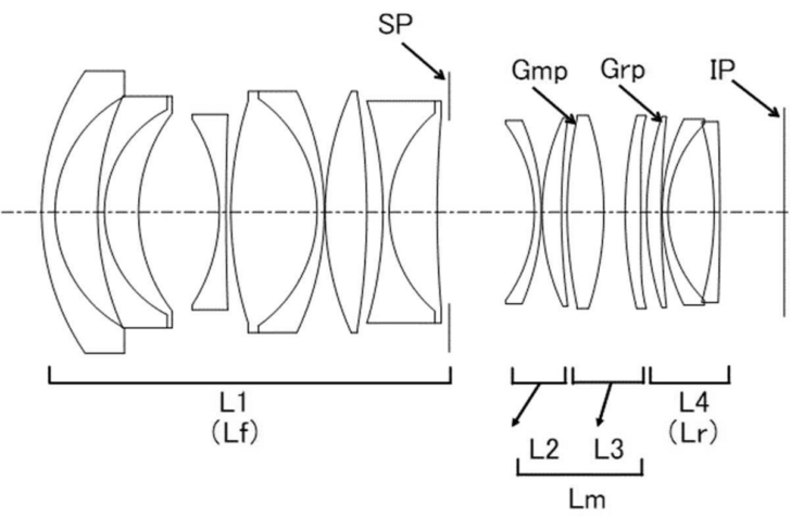

Option A: Canon RF 35mm f/1.2L USM
The lens design of the 35mm looks reasonable for Canon's premier 35mm lens with 17 elements packed into a lens around 130mm in physical lens length. The image height shows that this is meant to provide the full image circle with no stretching, as the image height is 21.64mm, suitable for a full-frame sensor size. The backfocus distance is inset into the mount by around 6.55mm, which again, is relatively decent for a prime and has been done before on the RF mount.
Nothing glaring seems to be out of order on this embodiment that would prevent Canon from developing this prime lens and releasing it to market. Of special note, L2 and L3 are the focusing groups, so this may require more than one focus motor to control both groups.

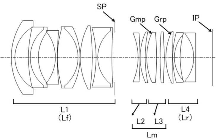

Option B: Canon RF 35mm f/1.2L USM
The second embodiment for a 35mm prime is surprising in its own way. It's small, since we have been told that size does not matter, let's look at this one. At a physical lens length of around 68.52mm, it would be remarkably smaller than the preceding embodiment. However, taking a 10,000-foot level at the patent application's lens response graphs, which I don't really read that much of, the first embodiment has less distortion, so to make the lens smaller, there's going to be more distortion to fix in post (not a significant amount, though). That could be a worthy tradeoff.

    @Richard CR: By the way, the two drawings of the options A and B look pretty similar.
    Why should the second one be so much smaller? Is there a different scaling? Doesn't look like that, comparing the front elements.
    Why should the second one be so much smaller? Is there a different scaling? Doesn't look like that, comparing the front element.
    the embodiments are not usually drawn to scale at all so I presume there's just less empty space. I was a little surprised by the lens length, unless there was an error on the patent application (possible).
    • 0
  3. ...unless there was an error on the patent application (possible).
    Maybe a "1" is missing and the length should read 188.52?
    OTOH the second drawing doesn't look more than 2 cm longer.
