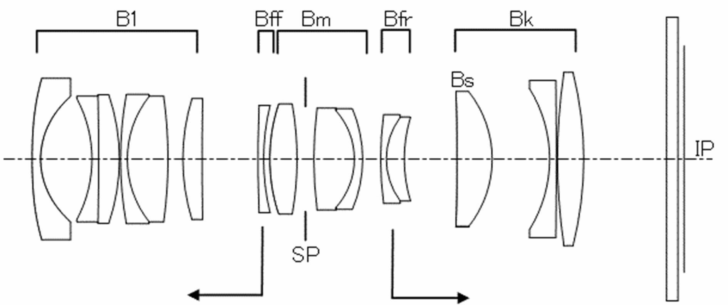

Canon has released the Canon RF 35mm F1.8 IS STM lens and the Canon RF 24mm F1.8 IS STM, so on the one hand, this patent application (2025-124117) seems a bit redundant if you look at it from a high-level point of view. However, in this patent application, Canon publishes a patent detailing several wider-angle macro lenses, all with 1.0x and 1.2x macro capabilities.
The designs are more complicated than we see with STM-grade lenses, so these may be a grade above. For instance, the Canon RF 24mm F1.8 Macro IS STM has 11 elements and eight groups, whereas the patent in question features 15 or so elements across 8 to 10 groups. Each optical element increases its cost, size, and weight. These would be unlikely to be cheaper STM lenses.

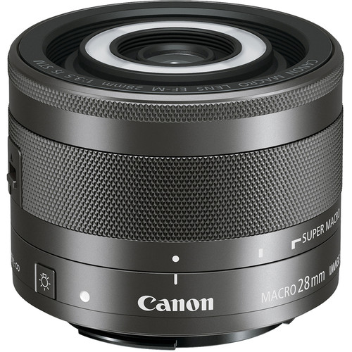

Canon first released a 1.2x Macro lens on the EOS-M and called it “Super Macro”. I had the lens, and frankly, I didn't find the 1.2x to be that useful – others may argue with me on that one.
Canon EF-M 28mm f/3.5 Macro IS STM
One thing is for sure: the macro lenses will need some form of illumination similar to the EF-M 28mm F/3.5 Macro shown above.
Canon RF 21mm F2.8 IS Macro
This macro lens has 1x magnification and a slightly smaller image circle than what is required for full-frame sensors.
Focal Length21.00
F-Number2.80
Half angle of view (°)43.60
Image height20.00
Lens total length116.37
Back Focus Distance17.14
Canon RF 24mm F2.8 IS Macro
This macro lens has 1.2x super magnification and a smaller image circle than what is required for full-frame sensors. A high degree of stretching would have to be performed to fill the entire full-frame sensor.
Focal Length23.00
F-Number2.80
Half angle of view (°)38.35
Image height18.20
Lens total length89.33
Back Focus Distance12.51
