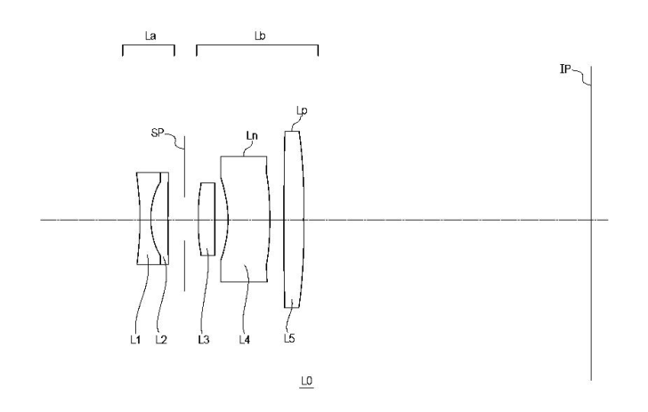

In this patent application (2025-029311), Canon features some rather slow, but very small lenses.
At first, I thought of these as pancakes and then doing something like math, it became obvious that these are much smaller than pancake lenses.
Just a refresher, when total lens length is mentioned that includes the back focus distance to the sensor. So, the 20mm that is between the camera lens mount flange and the sensor is also included.
If you deduct that 20mm, then you see that these lenses are incredibly tiny, but they still project a full image circle for a full frame sensor. Their simplistic design wouldn't lead to a very sharp and detailed image, but they would be very inexpensive lenses.
In these embodiments, I'm going to also calculate in the “actual lens protrusion” which is the distance the lens sticks out from the lens mount. That's a little different when the lens sits back in the mount further than the lens flange.
All these lenses are all F/8.0 lenses and when combined with the focal lengths they have a very deep depth of field. For instance, a 21mm lens at f/8.0 has a depth of field from 3.8 feet to infinity when focused at 10 feet away. I suspect these lenses would have a fixed focus distance, or a rudimentary manual focus.

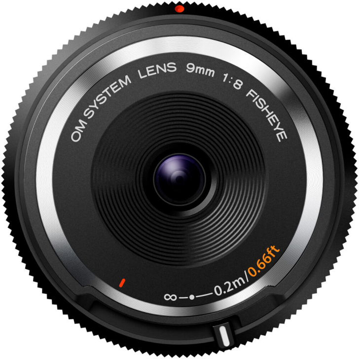

These lenses have been created by third party lens manufacturers, and even Olympus came out with one for the OM System Micro 43’s system.
The good thing about these lenses is that because the depth of field is so deep, if you simply turn on your camera and snap a picture, invariably, everything is in focus. This would be a perfect lens for the R100, since changing focus and everything but pressing on the shutter button on that camera is quite awkward.
These are fun “point and shoot lenses” and if they double as a camera body cap, all the better.
Canon RF 20mm f/8.0 Body Cap Lens
Focal length20.39
F-number8.00
Angle of view46.70
Image height21.64
Total lens length to sensor29.41
Actual lens total length14.42
Total lens Protrusion9.41
Back Focus Distance14.99

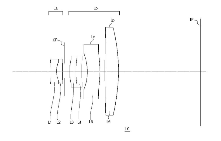

Canon RF 26mm f/8.0 Body Cap Lens
Focal length26.25
F-number8.00
Angle of view39.49
Image height21.64
Total lens length to sensor31.98
Actual lens total length11.98
Total lens Protrusion11.98
Back Focus Distance20.42

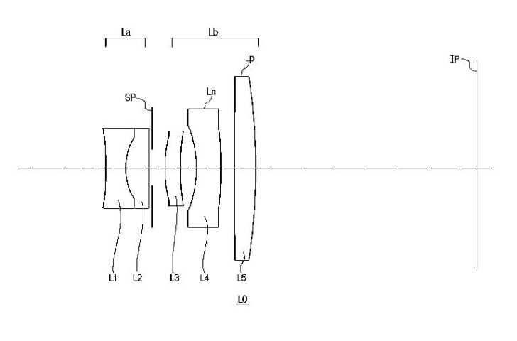

Canon RF 21mm f/8.0 Body Cap Lens
Focal length21.04
F-number8.00
Angle of view45.80
Image height21.64
Total lens length to sensor26.85
Actual lens total length12.17
Total lens Protrusion6.85
Back Focus Distance14.68
