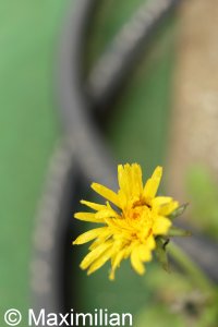

Only one I could find ad hoc is that one, shot near MFD and at f/2.8 with my old 100D, but that body seeemd to have a general AF problem.
Focus was on the middle of the bloom, so if I look at the water drops there might be some BF as well.
