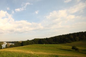

Without shift I didn't notice any barrel distortion. With maximum shift of 12mm barrel distortion is easily noticable as well as a lack of sharpness and resolution. Of course there is strong vignetting too.
See the attached out of cam JPEG as an example. The file was just reduced to 800 x 55 pixel. Full 12mm of shift was used and the lens was shifted to the right. It was a test shot, after my panorama shot was done.
The final picture taken with the TS-E 24mm in portrait orientation and later on stitched looks like this:
All shots were with the TS-E 17mm (attachment) and the TS-E 24 were taken with a tripod. Just the cam was moved on a panorama plate.
See the attached out of cam JPEG as an example. The oc was just reduced to 800 x 55 pixel. Full 12mm of shift was used and the lens was shifted to the right. It was a test shot, after my panorama shot was done.
There is no straight edge to determine any barrel distortion in that image. Also it would be nice if you gave us the actual dimensions and position of this crop within the image circle.
For a reference see the horizon above the lake. The cam was leveled. No correction of the horizon was done in post. The attachment in my first post is not a crop. It is the whole picture taken with the TS-E 17mm as it came out of cam. I just reduced the size to 800 x 533 to fit it into the attachment. I'm too lazy to upload it to my server.
The final image was taken with the TS-E 24mm in portrait orientation. 26 shots were stitched with Kolor Autopano (Exif data: Kolor stitching | 26 pictures | Size: 11514 x 5757 | FOV: 89.90 x 41.51 ~ 9.90 | RMS: 1.88 | Lens: Standard | Projection: Cylindrical | Color: LDR ). It should be a refence to show how the forest on the right side of the attached ouf of cam JPEG should actually look like.
RobertG. said:
OK, maybe I misunderstood what is meant exactly by "barrel distortion". English is not my native tongue. But my example shows that there is noticable distortion when full shift is used. Without shift everything is fine. But this is a shift lens.

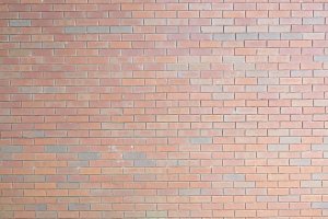

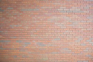

I hope the new lens is, too, and I found another example - the infamous brick wall showing obvious distortion of the zoom lens in comparison. Once again, you'll have to forgive the somewhat sloppy alignment of the camera to the wall, but I think it's enough to see the difference. Both shot at f/8, 0.6s, ISO 100, +1 EV,
Top: 16-35 f/4 IS @ 16mm
Bottom: TS-E 17
  • Wide_Angle_Lens_Shootout_Brick_Wall_Test_Lens-16-35f4IS_FocalLenght-16mm_Aperture-f8_SMALL.jpg

  • Wide_Angle_Lens_Shootout_Brick_Wall_Test_Lens-TSE17f4_FocalLenght-17mm_Aperture-f8_SMALL.jpg
