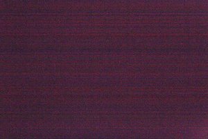

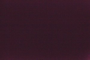

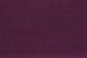

What I'm working on next is showing the whole image, reduced to 1/8 size in both dimensions, which gives a good indication of overall noise patterns and other interesting patterns that can provide clues to what's going on in the camera system.
I'm looking for a different scaling algorithm tho (I think I have a B-spline somewhere) as the usual ones for photographic work de-emphasize the overall luminance values too much so the scaled whole-image noise map is much darker than the 100% crop at a given ISO. That isn't a big issue either tho, since one scaled whole image noise map at one ISO will look pretty much like any other ISO level for a given camera. There's generally either repetitive fixed pattern noise (sensor or readout system irregularities) or random banding noise (internal power supply noise) which is never quite the same from shot to shot.
I've attached some 1/8-samples here, based at 3200 ISO, until I can devise a better procedure for processing and presenting these images from all the cameras. Altho you can still make out the patterns, the actual range of luminance variation within each image is greatly decreased by the scaling and jpg compression.
Also just noticed, the CR posting system here seems to rescale attached images to a max width of 702 pixels so the variation and relative size difference of the images below has been compromised a little more.
5D2, 5D3, 40D, D800

you can see the nasty 7D vertical banding, it had a special form of it that none of the other canon cameras had, it also varies quite a bit from copy to copy of the 7D and across the frame, with some copies have noticeably more than others overall and most having it vary in degree across the frame

Thanks for your feedback but I have to disagree with you on some of your points. Of course, if you don't know the background to this whole saga I can understand your point of view. :)
First, it's not meaningless at all, unless you don't do any serious adjustments in post, as some of us do. .. And not necessarily as a "correction" for something missed in taking the shot but as a way to help map the maximum dynamic range of our cameras to the very small dynamic range of a print or even a digital display. You can't multi-shot HDR moving subjects worth a fly-spec, neither should you have to with 14bits worth of camera raw data.
100% crops are useful just to see the small scale noise structure, like the fine banding of the 7D and 5D2 or some of the G-series cameras.
If I wasn't serious about this I wouldn't waste more of my time on it. It's my gift to you, free information on a topic that's so far been poorly addressed and inadequately covered, leaving many confused or uninformed. I'm presenting it in a way that will hopefully help more people understand the limitations of their gear so they can work around it and be more aware when they can encounter problems between shooting and processing.
I was ignorant of my camera's shortcomings and overly relied on it, being a bit of a fanboy at the time. Then, being unable to process some of my real-world shots for large scale printing, because the banding noise was an issue, is what started this whole project. However, even little 18x12 inch "snapshots" can show some banding noise structures under some conditions.
I'm tempted to say that anyone who hasn't run into this sort of problem is either shooting with some better cameras or hasn't yet had to learn how to wring the utmost from the equipment they have.
... But i won't. ;)
Marsu42 said:
* Comparing Canon to Sony's sensors (Nikon, Pentax): It is indeed the question how valid such an extreme underexposure and successive +ev correction is, or Canon would be broke by tomorrow. My idea: maybe another test with a dark grey background and moderate underexposure and post-processing +ev correction would put this into perspective? This is because that somewhat clever post-processing (software) will never try to raise black parts as far as you did.
Perfectly valid and that is one of the things I'm trying to devise a good in-studio test for because the black levels and the shadow levels can behave differently. The tests I've done and displayed certainly do not tell the whole story. But they are a good prolog for generating more awareness that noise structure issues are of some concern under certain conditions.
Marsu42 said:
* To me, the thing that kills my shots is banding. I guess there is no scientific number to measure this? If not, downsized shots would indeed offer a better basis for comparison since they'd show how much noise *pattern* is left.
YUP. That's it and I wish there was some measurement of this. I haven't found any yet so decided to try cover this topic.
I don't often downsize my shots so for me, pixel-level evaluation is where it's at.
If you're printing smaller then some of these things do get averaged out a bit.
Some cameras, with strong but fine-grained noise and no obvious banding, will not have major issues in post as NR can often mitigate the noise without hurting the actual image too much. Another camera can have weak levels of noise but a regular banding pattern to it may make it far less amenable to being pushed in post. The comparisons I've put up so far will at least allow people to see for themselves the type of noise their camera sensors are generating on a small scale. When I get the whole-sensor noise map up it's another story. Larger noise structures may then show up, as they do on the 40D sample near the beginning of this thread.
Marsu42 said:
* But most of all, I am stunned how much worse the 7d looks in this artificial test in comparison to the 60d. I have heard that the 7d is more prone to banding, but I'd never dared to mention it here because I'd get stomped. But looking at your 7d/60d pictures... am I missing something? They do use the same sensor, don't they? Is this banding due to some other processing in the 7d's dual digic cpus?
7D uses a "dual readout" circuit for faster shooting speeds. This may be the problem, with each signal path taking alternate 8-pixel wide swipes of data?.. If they're not perfectly matched, then banding errors show up in the final file dark areas. Fine vertical banding still exists (iso200, 400) on the 60D but it's MUCH more subtle, barely perceptable for the most part. The 5D2 is a bit worse than the 60D.
I've tested a second 7D and 5d2, they were nearly identical with the first samples. I suspect there may be some 7Ds that are cleaner, some that may be worse. if it weren't for the 8-pixel banding, I'd be pretty happy with mine!
LetTheRightLensIn said:
all as expected (well D4 looks better than expected) but it's interesting to see it visually
it is impressive - I hope there wasn't some hidden NR feature that I didn't find and turn off! The thing is almost TOO good to believe.
I've only looked at mine and one other and they both exhibit virtually identical noise behavior across the frame but I'd not be surprised there's variations, given the design.
.. i have a weird feeling the 1DX will test closer to the D4..
I certainly hope so. I was able to play with a pre-production one a little. menu is very similar to the 5d3, overall handling and feel was pretty sweet with decent ergonomics for the 10 minutes I played with it. If it wasn't for that sealed memory card door!...
One strange thing though is I havent seen numerical data hinting at the D4 being so many stops better DR at high ISO or the 5D3 being that many stops DR better there either. Something seems odd even considering ISO gains are not normalized and MP counts are not normalized.
What software was used to make these? Pre-raw processing software or just ACR which might do different things under the scenes for each?
Anyway interesting, never seen such an extensive comparison of this type before.
All processing done in ACR, so yes, could be some differences in the way it treats various camera files that user controls can't access. Best tool i've got for the job at the moment tho.
OTOH, the K5, D4, D800 and even the sub $700 D5100 all start off about the same in this race and the $ value starts to sort itself out as you move up the ISO scale.
This is still more of a noise measurement than a signal to noise measurement at this time.
Thus the various suggestions of doing this again at a low exposure value (not = to black) will bring a different context to put this in which will be more representative of real-world images and also may show some different behaviors from the cameras.
It's on the list of things to do. :)
