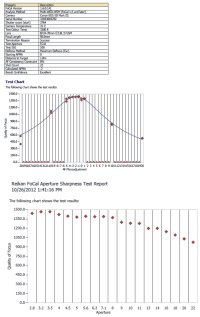

I have AFMA my 5D3 and 24-70mm f/2.8 using FoCal v1.6. I’m getting variations on the results and wondering if is this normal? I've searched the internet and the FoCal site for comparison but none that I could find except from this forum.
Comments are welcome.

Batteries were fully charged. The camera was mounted on a video tripod with fluid head and was weighted further by a 10 lb barbel. The height of the target (bullseye), and the center of the lens were the same. What concerns me is I am not getting a consistent sharpness 'reading'. Shouldn't I get the same resolution 'reading' even if the distance are varried?
@neuroanatomist: I have EV of 11.6
No, you shouldn't. If you change the framing, you're changing the size of the target image projected on the sensor. Further away (at same focal length) means smaller target covering fewer pixels on the sensor and thus a lower resolution. When you use a real test chart (ISO 12233 type), you must frame the full target for the resolution values to be accurate (there are framing marks on the chart).

Thanks a lot neuro! I was suspecting the same but can't quite pin down the reason until you put it together. What a relief! For a second there, I thought I have a bad copy. My salute to you!
There are lots ov variables, distance is one of them, its fine to vary the distance, but expect different results as well.
Notice how little variation there is accross the top of the curve, Just a tiny bit of difference will change things. The good news is that the sharpness doesn't change much from +2 to -2 so the setting is not that critical. Sharpness won't be a issue unless you get well down on the curve.
