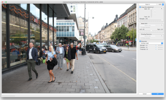

5D4 Dual-Pixel RAW Image Microadjust comparison to AFMA posted at DPR
and from that article (http://www.kamerabild.se/tester/vi-har-provat-canon-eos-5d-mark-iv?nodePage=3)
"In this case, the conditions were great for after adjusting the image because I personally think that the result was above expectations, although I had no expectations ...
future tests will show the tolerances required for a good end result, but this feature can really be very useful in certain situations, if you can make use of the altered workflow required (setting for the photo shoot, conditions and after treatment).
For best results, according to Canon using a focal length of at least 50mm and an aperture of f / 5.6 or lower, and an ISO setting of 1600 ISO or lower.
Photographs for example, a portrait with a 50mm lens, will the shooting stand 1-10 meters from the camera, at 100mm 2-20 meters, and at 200mm 4-40 meters from the camera."
So both articles are correct, just that one seems to have tested within Canon's recommended limits, no?

The article (from Sweden) posted on another thread showed some 2m/6ft shift on a picture taken with 35mm lens.
If that's not fake, I'm no calling it tiny.
I don't think that's the case, 2m of shift would be ground braking IMO. I'll bet it's more like 2mm. If you can correct focus by 2m I'll eat my shorts...lol
Also I think Canon would have made quite a deal about DPRAW if it was capable of 2m worth of focus shift, and not time code 2.05 where a few MM is shown.
https://youtu.be/VTt1bDcLFB0
The difference is much, much more than tiny ar +/-2 AF points. But the limitations of how much is can deliver compared to original FL, aperature and iso-setting may be why Canon is cautions about how and when it can be used effectively.

It's pretty obvious that the adjustment latitude is just a multiple of the available depth of field.
If you're getting 1" DOF normally then you might have about 3" of total range to adjust.
Oppositely, shooting with a wide angle lens set near hyperfocal distance may very well give you hundreds of feet of adjustment range.
Now I'm really curious about what happens when you try with a Tilt Shift lens.

DPRAW can give you focus correction from head to toe or nose to eye or any amount that you want, because you are in total control of the amount of correction available.
Right now all these ridiculous testers are just complaining about their own ignorance, setting up the camera to have a fraction of an inch of adjustment range and then whining about it.
You basically can't use the feature at 85mm f1.4, but maybe a lot of people would be better off if they did stop down a bit.
Ironically it's going to be people with zoom lenses and cheaper lenses who will benefit most.
