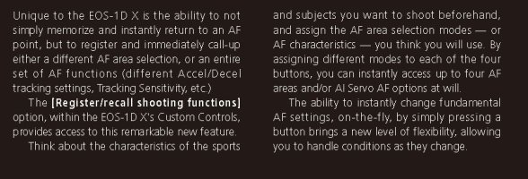

They say that the 1DX and 5D3 have the same auto focus system. So I am not sure exactly how the following applies to the 5D3? Different buttons?
"Unique to the EOS-1D X is the ability to not simply memorize and instantly return to an AF
point, but to register and immediately call-up either a different AF area selection, or an entire
set of AF functions (different Accel/Decel tracking settings, Tracking Sensitivity, etc.)"

Thanks, Michael. The question was asking about having the AF selection mode changed along with a switch to AI Servo with the single button press - can you confirm that the 'Switch to registered AF function' you reference also switches the AF mode from One Shot to AI Servo or vice versa?
The second post that was from page 48 seems to indicate that all functions can be set on the 1DX (which I see in your profile?)
There are 4 buttons that can instantly chage to a whole set of AF parameters. AI Servo, tracking characteristics etc.
Not sure about on the 5D3 for that one:
I believe that the AI Servo parameters (tracking speed, focus priority, etc.) can be registered, but not the AF mode itself - that seems to be what the manual indicates. It states, "Convenient when you want to change the AF characteristics duringAI Servo AF, not to AI Servo AF. However, I haven't tried it yet.
