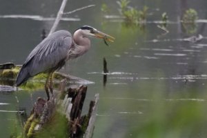

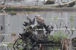

A couple of examples of the 100-400mm + 2x Extender II on the 7D below. Not the best day for it - gloomy and misty, and f/11 of course. Shot from a tripod. Both are at ISO 3200 and cropped a bit. The biggest challenge was focusing, which would have been close to impossible without IS on the lens.
Not bad at all. Seems like the most noticeable thing to my eye is the loss of contrast; certainly more than with my 1.4x. How much post-prod did you do on these?
FWIW, a while back I compared 100-400 @ 400mm cropped vs. +1.4x II and preferred the cropped shot. For the shot above with the 2x, I preferred the 2x to the crop, which seemed to have even less contrast - but the shots were 15 min apart (patient owlet!), so the difference may have been more due to changing mist than optics. Maybe I'll test both under more controlled conditions one of these days.
