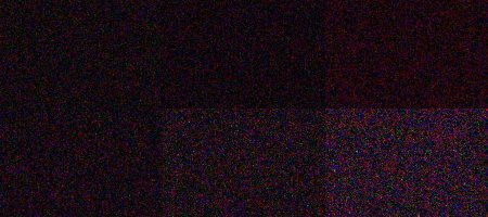

OK, finally took the time to put together the full stop ISO shots and bash them into a presentable form adequate for this purpose.
Shots are raw files taken at 1/200s, f/16, DLWB, all in-camera NR, ALO, and other features turned OFF.
Main LCD display is also set to OFF, except see difference it made when I forgot it ON in the first image.
Processing is done with my ACR standard of +4EV to bring the noise patterns up where you can really see them.
This camera's output at low ISO levels is a good bit cleaner with less banding than previous crop sensors like the 18MP one that debuted in the 7D and 60D.

These are full size crops from the +4EV push of the 70D raw files (via Adobe DNG converter and ACR as per my standard test method)
There are 6 samples here and I've organized them as follows:
COUNTER-CLOCKWISE FROM TOP RIGHT CORNER:
100 ISO - Main LCD was ON
100 ISO
200 ISO
400 ISO (bottom left corner)
800 ISO
1600 ISO (bottom right corner)
edit: Happily (?) we see none of the vertical banding that's plagued many of Canon's recent sensors!
