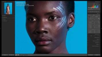

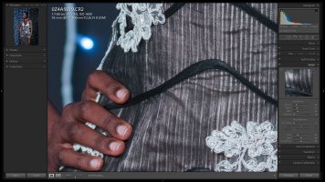

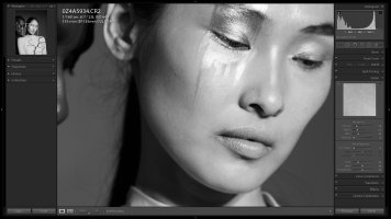

Just for interest... here are some Lightroom screenshots of 5Ds files. They were taken at moderate to high ISO settings at an event a couple of weeks ago. I've included the "navigator" window on the left so you can see location of crop in the frame. The much smaller pixels naturally give a finer grain quality to the noise, which I prefer. Personally, I found the 5Ds is a little bit laggy for my preferences so I'm looking forward to seeing how responsive the 5D-IV will be. I think 30MP could be a useful improvement over the 1Ds-III especially if Canon isn't too heavy handed with the AA-filter.
Did you know:
30MP is the geometric mean of 18MP (1D-X) and 50MP (5Ds/R)

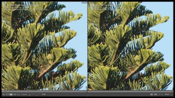

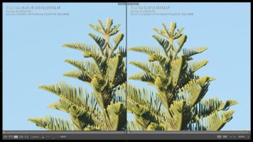

FYI... The highlighted text above was just based on my personal impression, and looking back I realized it is quite a bold claim as I hadn't personally done a solid test of this. Anyway, I had some good weather today so decided to put my gut feeling to the test.
Methodology:
Set up 70-200mm on a tripod
Same settings on both 1Ds-III and 6D. (1/100s at f/6.3 ISO 100)
used 10x magnification in live view focused on same branch
Opened RAWs in DPP, removed all sharpening and noise reduction
Exported to TIF
Imported to Lightroom
Took screenshots of comparison view...
Attached are the screenshots:

Looks like you were right, but the thing is anyone post processing their images, and especially those who shoot in raw, can very quickly deal with the sharpening in such a way as to make those two images identical as far as sharpness goes. The 1DsIII has recorded the information. This is why if I do get the 50 mp 5D it will be the 's', not the 'sr'.
