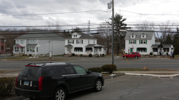

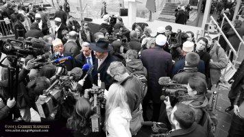

I don't know about everyone else but a friend aka stringer sent me screenshots of videos and picture and the video is very noisy, looks terrible,
i tried the to compare my videos with photo taken at lower res as well and no matter what i did the video paused looks nice and large but the quality and noise can be compared to my ipad 3, total joke.
look at these taken by the stringer, first is a photo and then a video, totally different under the same day light and settings, he says they where taken with a 25/105mm lens, 125/f8, the video was shot at ALL-i

Well video is video it's not meant to substitute taking photos. Pausing/taking a screenshot will never beat photos, while I've pulled stills from my 5DII that look as if they were photos (can post if request maybe), just less resolution and little information to edit. Also, the Mk3 is softer in video than the Mk2, while the Mk2 is sharper is suffers from moire.
I haven't heard about the iPad being production ready in quality... but of course in this case only the 5D can get nice and shallow when needed... the shots are obviously edited there, was that after receiving the stills and editing yourself or was it that way when you saw them? Because all that loss in quality/noise might as well come from whatever editing took place, this doesn't look like the rawest data to judge with
The video from the Mark III is pretty soft with some chunky noise but that second shot is unusually bad and was either shot or processed wrong to look like that. At best, Mark III footage won't look quite as good as the first frame grab, no matter what you do in post or on set. But it can get reasonably close. I don't know about the iPad but under ideal conditions the iPhone is sharper with better resolution than any Canon dSLR, but with less manual control and a worse "look" obviously. But for exterior video in low contrast light in wide shots in some cases it might produce the better image. I wouldn't count on it, though.

Absolutely, but the Mark II and Mark III produce very similar footage (excepting aliasing issues) at low ISOs, with the Mark II arguably having the edge slightly for sharpness (due to false detail) and having a bit less read noise. At high ISOs the Mark III is far nicer, but this isn't that.
Again, the footage posted above is WAY worse than what the Mark III is capable of, and it's also under the conditions that are least impressive with the camera. But the crop taken from a still is better than the camera will ever produce for video.

Are you playing back the footage inside of a NLE or just the original files? If it's in an NLE the quality will degrade when you press play but when you pause it goes back to full resolution.
As for ALL-I vs. IPB, pretty much all the tests say that there is no difference in image quality and the few people that have claimed to see a difference usually say it's the IPB that looks better. Pretty much the only advantage of shooting ALL-I is that your NLE will run much faster since it's already optimized for editing. Other than that it's a waste. I've shot hundred of videos in IPB and have never had any problems.
The first still looks about how the Mark III video should look, but something is definitely wrong with the 2nd one.
