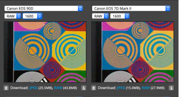

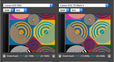

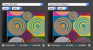

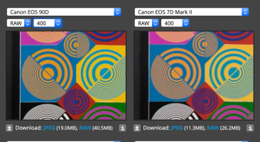

Thanks for replying Glenn. I don't understand how a series of shots under carefully controlled conditions by dpr can be so wrong compared with yours. Here is a series from the dpr comparator at iso 400, 800, 1600, 3200, 6400 and 512,000 for the 90D on the left and 7DII on the right. The noise levels look pretty similar to me at each iso and you can see what a stop difference in iso makesiso400_Raw.pngiso800_raw.pngiso1600_Raw.pngiso3200_Raw.pngiso6400_Raw.pngiso51200_Raw.png.
