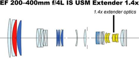

I’d prefer a teleconverter that could be moved to an “off” position. Add 1.4 when you want it , plain glass if not. It would be usable on multiple lens. I suppose it would have been invented if it were possible.
The current EF 200-400 f4 LIS employs such a design. The 1.4x TC is flipped into the optical path and then flipped out when not in use. Nikon emply a similar design to their current super-primes....I can't call them super-whites because theirs are usually painted black!
It’s technically possible, the problem is that the off position would still require optics. That’s because if the 1.4 X elements were just flipped out of the optical path, you’d be left with an extension tube that would eliminate infinity focus for the lens.
An internal switchable teleconverter is possible for a dedicated implementation on a lens, because there are optics behind the TC position.
