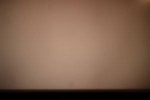

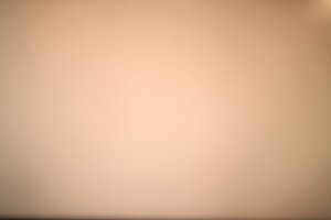

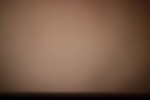

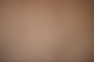

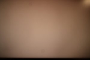

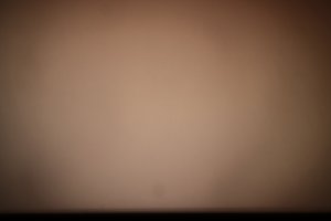

Yes, I cleaned my sensor and I've tested with another lens. Same things that I've mentioned before - spots generated by lens on 24mm.
Now I'm trying to show a spots on photos.
Spots visible very well on 24mm f22. (horizontal and vertical shots)
But when I zoom in to 35-37mm - they not showing. Same thing on f8.
Hope I've illustrated problem well...

I would put money on that being on the sensor, not in the lens, especially as they are towards the edge of the sensor and you say you've cleaned it......
Have you tried with another wide angle lens at f/16 ?
Yes, I have 15-35... I've tested it, no spots. But tomorrow I can repeat (have no time today) to be sure.
But why on 35mm I didn't see any spots ? I guess its because some part of edge of lens dont using when shooting on 35mm. No ?
