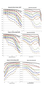

I took two test Roger did and combined the charts. Hope this is legit (tests were done the same way) and I am not stepping on anyone's toes.
Thought I would share what I found. Note perfect match as far as focal lengths go (except for 24). Not sure if Roger tested the Canon at F4 and Nikon at F2.8 - I think he did.
My observations: at 24 Canon is sharper (if MTF means sharper) until the very edge.
No direct comparison at 14 but can compare Canon 11 and 16 to Nikon 14. Not sure what to make of these charts. What do they mean to my images?
