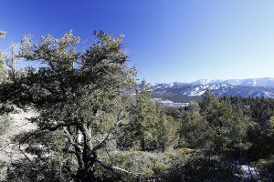

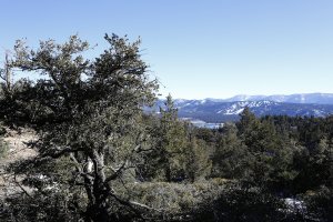

Boring examples attached. One with the maximum polarization, one with minimum. Shot on a 5D3 with the 24-70 F/2.8L I on the 24mm end. Straight JPG off the camera (I usually shoot RAW), re-sized only.
