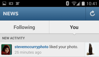

Thanks for the link - I'm a big fan of Steve McCurry and whatever his work may lack in sharpness, he more than makes up for with his composition, color, and emotion. He's also given me the highlight of my Instagram use since getting on there a few months back :)
privatebydesign said:
Sweet, but you have to tell us which was the photo?
Thanks and I couldn't believe it! It was the eagle in flight beside his comment - larger size below:
