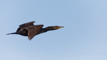

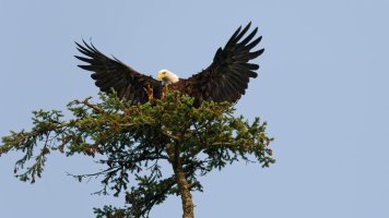

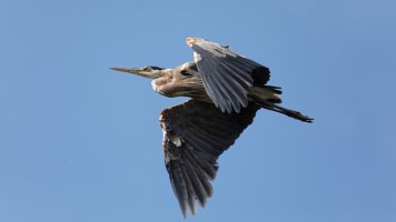

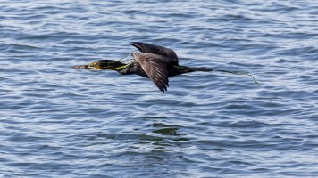

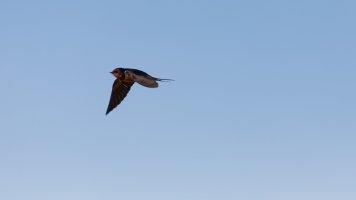

On my 5D series, I have C3, C2, C1 programmed to be sticky on my standard settings for BIF, backlit and normal perched birds, and M and Av or Tv for more immediate changes, and use muscle memory to flick through. You should be able to click and expand the images here. I download the more interesting ones to look at.
Ugh. Have to find a better way to reduce for uploading. Compared to my hard copies here those look terrible... hehehe..
