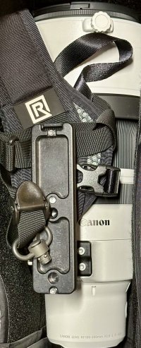

Guragear kiboko 30l +. R1 with 100-300 f2.8 with hood out and in. Hope this helps.
If you’re open to an unsolicited recommendation, the extra bulk of the Arca plate attached to the Canon foot and the BlackRapid lug attached to the plate could be reduced. I use the Really Right Stuff LCF-53 replacement foot on mine, it has a QD socket that allows easy connection of my BlackRapid QD strap.
Thank you. Does it come with an AirTag slot at all?
Nope…though after your question, it looks like yours does. What brand, if I may ask?
Hasn’t been something I’ve worried about, my gear is insured (well, everything >$1K). Though an AirTag in my luggage did enable me to locate my bag the airline left in Rome as we were flying from Venice to Calabria and fetch it before it would have been delivered (Al Italia’s chosen local courier ran on Italy time, and I was on Sicily and needed the diving gear that was in the suitcase sooner).
Plusnq, thank you!!
As neuroanatomist provided me with the accurate dimensions, actually seeing the R1 with 100-300mm 2.8 in the GG 30l really helps. It’s almost as I imagined. Not a lot of room with the hood in place, which is ok. With the hood reversed, I should be able to put the rain cover at the end of the bag or one of the extenders.
Even though all my camera gear is insured, I really like the SmallRig plate with the AirTag.
