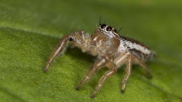

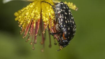

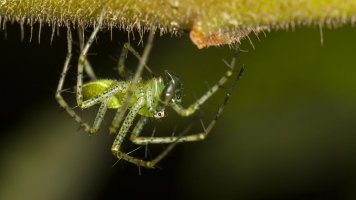

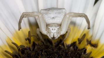

Some of my pics taken over the last 3 weekends or so. All with my ringflash. (resized to have the long edge at 1024px)
