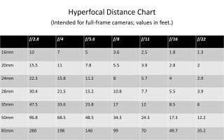

Also without reading the entire article this table might help (taken from the article).
As you can see with an 85mm lens and at close distances you have to stop down quite a bit and I'm not sure you could achieve hyperfocus at 1.5metres. Also, at f/22 flash power will be severely diminished.
It's better to use a 35mm or 50mm lens and crop in post.
