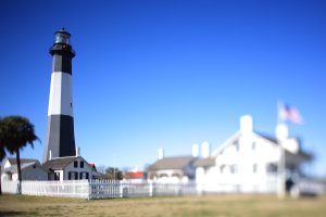

I did this one handheld. Far from perfect. But pretty good considering it’s the Canon FD 35mm T/S adapted onto an R6 in some pretty high wind. That IBIS really pays off.
I’d definitely buy some crazy RF mount autofocus T/S if they make it though.
