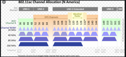

Channel 9 shouldn’t be an issue, but you could move it to a full channel, like 1, 6 or 11:
Channel 100 is in the DFS range, but as you say, the R5 can see it. Moving it out of DFS could help, e.g. channel 36-48:
As for rebooting the router, if you pick a channel in the DFS range, the router needs to scan it for interference first, that can take a few minutes. On my access points at home I can see it take 10 minutes from time to time, usually in situations where a new toy won’t connect to wifi :)
The above chart is for north America, but unii 1 and 2 match Europe, I suspect they match Japan as well.
