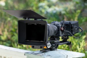

Just wanted to share an image of how I’ve kitted out an R5 for video duty. So far I’ve used it on four shoots each a full day, using the external recorder without overheating (running firmware 1.0).
I did get the temperature warning at one point when I had to shoot some 120p internal but got what I needed before any issue arose. I filmed a 40+ minute interview in the 5.1k oversampled crop mode at 24p with no warnings.
Averaged about 3 LP-E6N batteries each day.
The RF 24-70 is a fantastic video lens with minimal focus breathing and outstanding stabilization with the aid of the IBIS. Rock steady handheld shots.
Mattebox is a Bright Tangerine Pola+ with Schneider RHOdium NDs.
