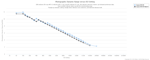

Disclaimer: I don't have R3 or R5mk2. But I'll let data speak.
If low light performance is the main factor I'd refer to photonstophotos.net.
R3vs. R5mk2:
So in pure sensor performances it seems that above ISO 1000 you will lose about 1/2 EV with the R5mk2 sensor.
Therefore, you'll gain +87% amount of pixels. With R5mk2 you have the advantage of either more cropping possibilities or downsampling the pixels to get better DR. (edit and corrected: I meant.... s/n level. Therefore, you gain DR over the noise level.
As you have experience with the R5 (mk1) consider the sensor as almost equal to the R5mk2. Did you like it?

The R5mk2 offers 187% of the R3 pixels. But you gain +87%.
About AF and tracking: I guess that the mk2 has improved a lot over the R5, getting also a lot from the R3.
So IMO it'll be only about the noise in low light vs. more pixels.

For those interested, DR is measured on photons to photos at a fixed physical size of output at a fixed distance (not on a per pixel size basis)- typically an 8" wide print at arm's length. So, a high resolution print/image is automatically "downsized" to the same physical size as one from a low resolution sensor. If you downsize the high resolution one in advance by merging pixels, you then have to enlarge it more to be 8" wide and the effects of pixel merging cancel out.
