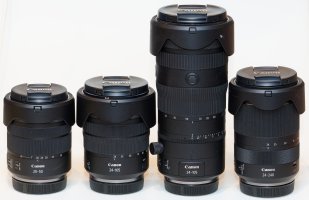

I was hoping for the lens to be a bit smaller, it's only a bit shorter than the RF 24-105/4L. Though the 20-50/4L does not extend with zooming, that's of less concern to me than the amount of space a lens takes up in a camera bag. One big difference is the weight – at only 425 g, the 20-50/4 is easy to carry along and much lighter than the 24-105/4L that weighs in at 700 g. The 20-50/4 is also significantly skinnier – holding one in each hand, the PZ lens feels smaller and much lighter.
Choice is a good thing, but I now have several choices for a zoom lens covering the standard range for local or travel use.

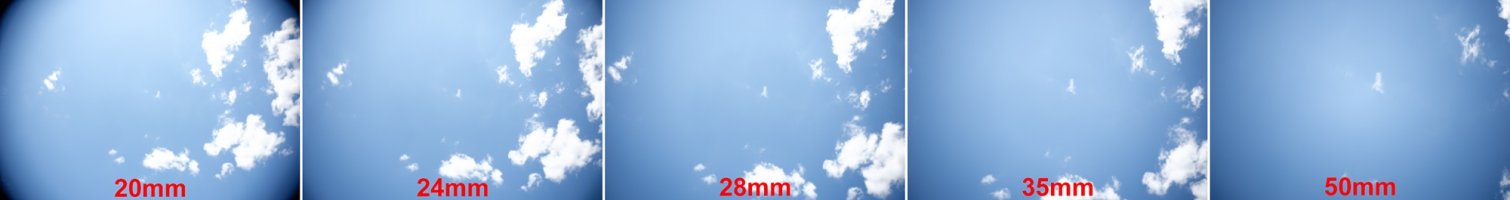

As expected, the lens requires distortion correction at the wide end (RAW images from DxO below). The image fills the frame between 23-24mm, with some residual optical vignetting that is mostly gone by 28mm. Wide open vignetting is not bad, though that's expected for an f/4 lens.
