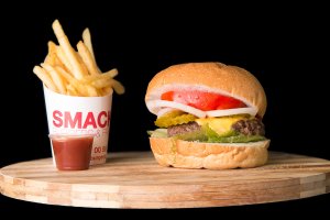

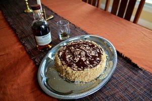

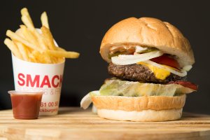

A friend asked me to shoot some photos for his restaurant's menu, its a first time for me, and I know that its not easy, but he just wanted shots of the items as is, so no fake components or makeup, the items were cooked as usual, here are some of the results.
