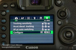

I find that the 6Dmk2 actually shares much of its AF configuration options with the 5D series, the 7D2 and the 1DX bodies, but those options are just not grouped in the same dedicated AF menu tab, and there are no AF Cases. The AF Cases on the 1DX, 5d and 7d2 cameras are really just a grouping of three parameters.
1. Ai Tracking Sensitivity;
2 Accelerate/Decelerate Tracking
3. AF point auto switching.
So the 6Dmk2 has all of those options, they are just individually listed under the C.Fn Autofocus menu.
For me, I don't personally use any of the AF Cases per se, on my 7D2, 5D and 1DX bodies, by choice. I find it easier for me to actually try understand what the AF is doing when I make changes to those parameters, rather than picking a preset Case and trying to then deconstruct what may be working for me or not. Therefore I use the My Menu tab on my 7Dmk2, and my 5D, 1DX bodies to select those three AF parameters and keep them instantly available so I can make changes one parameter at a time. I have attached a quick image of the back screen of my 7Dmk2 in My Menu to show the three AF parameters. I do the same with all my Canon bodies. I also usually include Ai Servo image priority in that screen.
