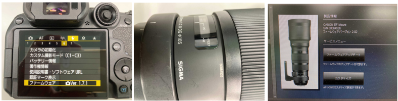

Final update on my Sigma 120-300 f/2.8 Sports compatibility nightmare with the Canon R7.
Latest from Sigma Japan:
Sigma Japan followed up again and provided some really helpful information:
The Good News:
  • Sigma Japan sent me photo and video proof of their 120-300mm f/2.8 Sports (Ver. 2.02) working perfectly on an EOS R7 (Ver. 1.7.1)
  • They've already contacted Sigma Germany on my behalf and briefed them about my specific issue
  • Sigma Germany has an R7 with firmware 1.7.1 and can fully test my lens when I send it in
  • They're confident the service team can restore my lens to working order
What They Suspect:
  • Since all my other lenses work fine on the R7, the camera itself is not the problem
  • The issue is definitely specific to my individual lens unit
  • They mentioned the repair might involve "updating the lens in a different way than using the USB dock" - which suggests some kind of internal calibration/firmware procedure beyond what we can do with the consumer USB dock
Next Steps:
  • Sending my lens to Sigma Germany for inspection and repair
  • Sigma Japan has already coordinated with them, so they're expecting it and know the full background
  • They're confident it can be fixed
What This Means for Others:
If you have this same issue (120-300 Sports + R7 = Err 01):
  1. ✅ It CAN work - Sigma has proven it with their test unit
  2. ⚠️ Your specific lens likely needs service - not a general compatibility problem
  3. 🔧 Contact Sigma with your serial number - they can coordinate repair through your region
  4. 📹 There's apparently a special calibration process beyond USB dock firmware updates
I'm honestly impressed with Sigma Japan's level of support here - they personally tested it, sent proof, and coordinated with the regional office on my behalf. That's pretty solid customer service.
I'll update once the lens comes back from Germany and (hopefully) works on the R7!
Thanks again to everyone who suggested escalating this - turns out persistence pays off.

Subject: ✅ SOLVED: Sigma 120-300 f/2.8 Sports + Canon R7 Issue - Firmware fix worked!
Hey everyone,
Final happy update on my Sigma 120-300 f/2.8 Sports compatibility saga with the Canon R7!
TL;DR: Problem is FIXED! 🎉
My lens came back from Sigma Germany today and it's working perfectly now on the R7:
  • ✅ Autofocus working
  • ✅ Aperture control working
  • ✅ Image stabilization working
  • ✅ No more Err 01!
What Sigma did:
  • Inspected the lens
  • Applied a new firmware update (not available via USB dock)
  • Tested and confirmed compatibility with R7
Everything functions flawlessly now. The whole process took about [insert timeframe] and the service was excellent.
IMPORTANT INFO for others with this issue:
After I posted about this, Sigma Japan shared some really valuable information with me. Turns out I wasn't the only one - there's a Korean photographer who contacted Sigma with the exact same problem:
  • His 120-300 f/2.8 Sports worked perfectly on EOS R5 and Nikon Z8
  • Did NOT work on EOS R7 (same Err 01, no recognition)
  • His other Sigma lenses worked fine on the R7
  • Both he AND his brother have this lens, and BOTH had the same R7 issue
Here's the key detail: Sigma Japan mentioned that both of these lenses have older serial numbers from before they switched to Toshiba CPUs. This suggests the issue primarily affects older production batches of the 120-300 Sports.
Sigma's technical conclusion:This is NOT a general R7 compatibility problem. It's a specific communication error between certain individual R7 bodies and certain older 120-300 Sports units (particularly pre-Toshiba CPU models). The special firmware calibration they apply during service resolves the communication protocol mismatch.
