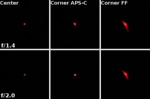

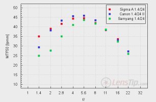

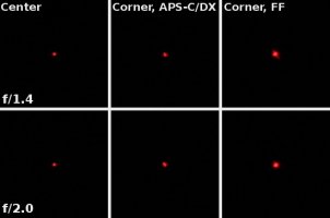

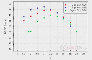

From Lenstip:
http://www.lenstip.com/index.php?test=obiektywu&test_ob=430
"It is obvious at once that the 1.4/24 model is far more difficult to produce than the 1.4/35. In a range from f/5.6 to f/16 both lenses are practically indistinguishable but in the f/1.4-4.0 range the lens with a longer focal length prevails decisively."
I know resolution isn't everything, but clearly Sigma had a harder job at 24 than they did at 35 or 50.

From Lenstip:
