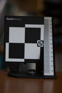

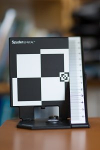

Yesterday I received my new Sigma 50 art ;D I immediately tested it (on my 5DIII) and found some shocking results. :'(
I have not calibrated this lens yet. Attached are two pictures, both taken at f/1.4. First picture: I used center AF point. Second picture: I used an AF point on the very far left. I contacted Sigma and they say this is not normal.
What are your experiences? Is this likely to be a fault with this single lens or do all sigma 50 art's suffer from this issue?
Thanx!
Niels

Transport damage maybe? I mean Sigma already said it's not normal, so it's probably simply broken or a de-centered element.
If it would be transport damage, you would also expect to see reduced sharpness when you manually focus using live view, right? Because if I do this, the image is perfectly sharp, even wide open. Significantly sharper than my Canon 50mm f/1.4 (which you would expect).
I have never seen such a dramatic variation from AF point to AF point, but apparently that is a known issue with this lens.

I have received a second lens and tested a third copy. They all have the same issue, although the second copy is much sharper. I have contacted Sigma. The say that firmware is nonsense and that the AF-curve is not flat. Sigma can calibrated if you ship the lens to them (in the Netherlands at least). They charge 60 euros ($90) for calibration.
