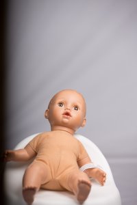

kat.hayes said:I am using a studio light with a shutter of 1/250. Please pardon my ignorance, I am new to all of this. I have been using these settings for many shots I took yesterday while practicing with the light and I did not have this issue. Perhaps my settings were slightly different and I didn't realize it? What is the issue?
Thanks!
1/ All cameras have a sin speed after which the shadow will appear, the 1 series have a 1/250 sync speed, the 5D MkIII I thought was 1/200 but if the lights are 'slow' you can get the shadow slower, some cameras the sync speed is even lower, back in the day of magnesium bulbs 1/60 was standard!kat.hayes said:I just did some tests.
- The shadow appears at 1/250, much more pronounced at 1/320
- it seems to be gone at 1/200 (though I am only viewing on my viewfinder so I can't tell if there are any subtle remnant shadows there), at 1/160 it seems gone
1. Is this a universal regardless of camera guideline to keep the shutter slower than 1/250 or is it just with the 5DM3?
2. Does this also apply when shooting with a flash?
3. If using a studio light or a flash and not trying to get ambient light should I just always set the shutter at 1/200 or 1/160 and keep it there to avoid this? Is there a need to go slower than this?
Thanks so much, I thought I had some issue with my shutter!!!
I've pasted in the specification for the 5D MK III below. The X-Sync of 1/200 means that a faster shutter speed may not be synchronized with your flash. There is some variability in lights and the timing of their flash, so to be safe, 1/160 max unless you really need 1/200.kat.hayes said:I am using a studio light with a shutter of 1/250. Please pardon my ignorance, I am new to all of this. I have been using these settings for many shots I took yesterday while practicing with the light and I did not have this issue. Perhaps my settings were slightly different and I didn't realize it? What is the issue?
Thanks!
privatebydesign said:kat.hayes said:I am using a studio light with a shutter of 1/250. Please pardon my ignorance, I am new to all of this. I have been using these settings for many shots I took yesterday while practicing with the light and I did not have this issue. Perhaps my settings were slightly different and I didn't realize it? What is the issue?
Thanks!
No issue, your camera sync speed is not 1/250, try 1/160 and the shutter shadow will go away.
