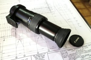

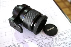

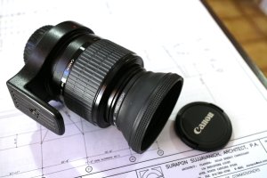

I use a filter on mine. The working distance is short, I'm always pushing the end of the lens into bushes, etc. I do have the hood, and I don't find it particularly useful.
I also use a Macrolite 58C adapter to replicate the mounting groove for the MT-24EX after putting on the filter. It's not necessary if you'll always use the lens with the MT-24EX mounted on the front of the lens, because the mounting ring has a 58mm thread, so you can put the filter on the mounting ring for the flash. However…doing so precludes use of the hood. The purpose of the 58C is so you can put the MT-24EX on the lens after the filter (i.e. the filter is screwed into the lens threads, which blocks the MT-24EX mount ring from reaching it's groove, and adding the 58C to the front threads of the filter provides that groove).
