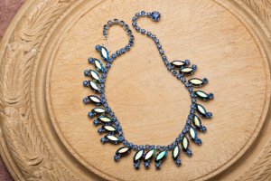

I just looked up 'Decentering' and I am not sure if this applies to my issue. Forgive my inexperience, but when I say that the edges are soft I wonder if this is simply a Depth of Field issue, because the top portion of the image is out of focus? At f16 should the whole image be in focus from front to back?
This image is not parallel to the subject, does this make a difference?
Anyway I have enclosed an example jpeg.
D

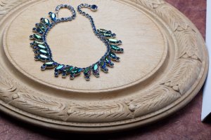

The second image is an almost parallel to the subject photograph, and at f16, the corners are alot sharper, with some feint softness at the very edges. At f22, it is sharper still.
Is the issue still decentering, or is it the position of the camera?
Thanks,
D.
Sorry if I've mis-understood you, decentering is really when one edge/side is different than the other(s). If you want to really test your lens, there's no way 'round printing and shooting a test chart.
Hahaaha, no way, calculate to see the average depth of field (for a standard print/view size): http://www.dofmaster.com/dofjs.html
Sure, that's why you do focus stacking, you cannot get infinite dof es. at close distance no matter how small the aperture. Or try f222 instead of just f22 :->
