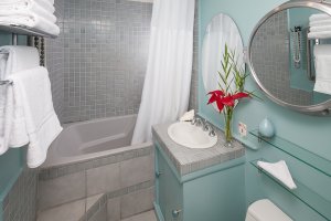

I was photographing interiors and my kit includes both Einsteins and speedlights, Canon and Vivitars. In a small bathroom I planned to shoot from the door and snuck an Einstein head up next to me such that the head pointed straight up at the ceiling over my head. Satin 7.5 inch reflector. Dialed down to something like 100, 200WS, because it was a small bathroom and light in overall color (white ceiling). Attached directly to the 1DsMk3 by its own Buff-supplied PC cord. 17TSE on the body.
This body had been used on other rooms with just Einsteins (multiple heads) all good so far.
I had placed a Canon 580EX in the bathtub to brighten up the shower curtain and the matte-finished tile. It was mounted on a small stand up on top of a Phottix Odin receiver into which I had plugged a FlashZebra orange optical slave made for Canon triggering (FlashZebra has different models.) Odin "on" and set for Group A, Channel One. The speedlite was behind the white translucent cloth curtain pointed away from the lens. The Odin was underneath it and the slave stuck out the "back" of the Odin toward the camera position and therefore toward the strong pulse from the Einstein.
What went "wrong"? This: On first curtain setting only the Canon's light showed up in the exposure. Everything fired, though, and apparently at the same time. Tried it about five times. Get this - I was dragging the shutter to let a ceiling light show in the image, so I wasn't anywhere near 250th. No banding showing on the screen. Change to second curtain and it works fine.

I set that 580EX for manual, dialing it down to barely show. I never use ETTL when placing speedlights in set scenes. So no preflash. Perhaps, since I could not reproduce the problem (although it happened twice ) it is a different unit from my four Einstein heads and isn't reproduced because that's not the head I tested with last night.
I'm attaching the shot, and it was one of the two on which I saw the behavior.
