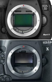

And remember: The seal at the lens mounts will only work with a select few professional Canon bodies. Canon 5Dii and below need not apply.
Thanks for the link! The Google translation suggests that the bodies with some degree of sealing (which includes crop models down to the 50D, and all of the current/recent FF bodies including the 5DII and 6D) are dust- drip-proof compatible, although the better sealing of the 1-series bodies is mentioned in a subsequent footnote.
But there's a obvious and likely important difference in the design of the mounts on the 1-series vs. most other 'sealed' bodies. On most Canon bodies (e.g. the 5DIII shown below), the area immediately surrounding the lens mount is the same slightly textured surface as the rest of the body. That textured surface may not be ideal for sealing against the rubber lens mount gasket. The 1-series bodies have a smooth plastic ring surrounding the metal lens mount, and that may form a better seal with the lens gasket. Interestingly, the new 7D Mark II has that same smooth plastic surface surrounding the lens mount as seen on the 1D X below.
Interesting. Being a lower-tier body user, I was unaware of that difference of texture in lens mounts. I guess I'll just have to whip out the 600 grit sandpaper!
