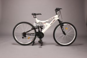

Hello folks,
I recently set my white balance using a new grey card. After that all my pictures seem to have a red tint to them.
I'm using a Canon 600D with Elinchrom flash units and a Mennon grey card.
Before using the grey card i just used a piece of paper for setting white ballance. Seems like i get pretty much identical results with paper and the grey card. - When using the paper I manually added blue in the camera settings to compensate for the red tint. - looks like I have to do the same when using the grey card (somehow makes sense ;) )
When I open the files with the grey card in it and hold my eyedropper on it in photoshop, the color in the card is perfect grey (identical RGB values) - but everything looks reddish???
Just calibrated my screen with no improvement.
Same result on 3 different cameras and different monitors.
Any ideas? Does the background have a red tint or is the balance off?

Blindman,
It seems to me that the bike in your picture is fairly neutral. The black tires, silver wheels, and the bike frame don't seem to be carrying much of a cast at all...which is what I would expect being that they are lit by your strobes.
A potential problem enters the equation in that you have a good amount of light fall off on your background. There are a number of things that can cause a color shift in areas of a photo that aren't being fully illuminated by your strobes. These causes can include:
1. An ambient light source bleeding into the exposure, particularly the shadows
2. A portion of your strobe light bouncing off a colored object (walls, ceiling, furniture) picking up a color cast and projecting that cast on the background. In this scenario, any direct strobe exposure wouldn't exhibit the color cast.
3. Your strobes themselves operate at a certain color temperature that could be off from a neutral temperature...thus shifting the color of the areas not being fully lit by them when you balance for that light.
4. Modifiers can also shift color balance of the strobe leading to problems described in # 3
5. It appears your using a grey seemless, these can exhibit different color characteristics when lit or not lit and it varies among different brands.
You should certainly follow the advice of others concerning white balancing techniques but it is important to understand that there are other factors that contribute to the characteristics of color in a photo even in a studio environment. Knowing how the color temperature of light works is important in controlling your white balance. Light sources, modifiers, environment, and lighting technique can all contribute to color shifting in a photo...even when a white balance technique is used.
I would advise looking into these different aspects as well as refining your white balance technique.

measuring this picture over here, it does have more red in the RGB, so the background is not neutral,
