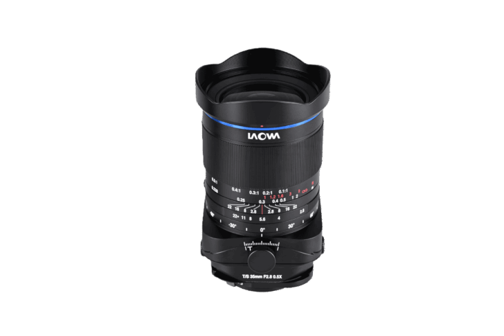

Laowa is at it again, with another unique lens offering. Laowa today announced the 35mm f/2.8 Tilt-shift lens with a .5x Macro, named the Laowa 35mm f/2.8 Zero-D Tilt-Shift 0.5× Macro. Since this lens is manual focus only and has no electronic connections to the camera body, it is also available for the Canon RF mount. The lens is released for the Z, E, and L mounts, and is also compatible with the Fujifilm GFX and the Hasselblad XCD mounts.
The lens will shift on full-frame cameras ±12mm, giving the users a pretty impressive wide range to move the lens. On the medium format sensors, because their sensors are larger than full frame sensors, the amount that is shiftable is ±8mm.

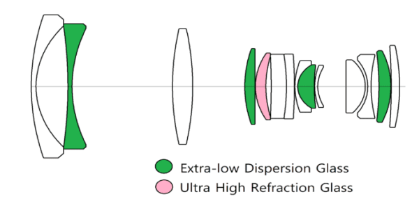

The lens itself is 14 elements across 12 groups, including 4 extra low dispersion elements, and 1 ultra high refractive element. It also has Laowa's hydrophobic coating, which they call frog eye coating, on the front element to help repel water. I would “assume” that operationally, this is similar to Canon's fluorine coating.
Laowa 35mm f/2.8 Zero-D Tilt-Shift 0.5× Macro Elements

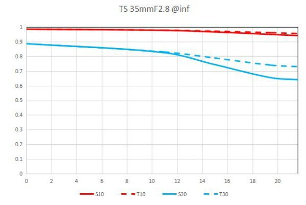

The MTF looks very good as well, even though it should, because it's only showing the unshifted image circle. I guess if I had much to criticize Laowa's impressive lineup of tilt/shift lenses is that they dont' show the MTF of the shifted areas so people could get a feel of how well the lens performs shifted.
Laowa 35mm f/2.8 Zero-D Tilt-Shift 0.5× Macro MTF

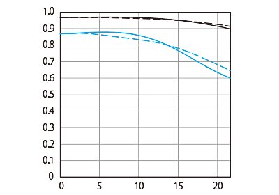

But to be fair to Laowa, Canon was rather reluctant to show that information as well.
TS-E 50mm f/2.8L Macro MTF
While this is a 50mm Tilt-shift lens from Canon, the TS-E 50mm f/2.8L Macro, we can see that it has a generally similar MTF response, though keep in mind that the Canon lens is around $1000 more expensive.

  1. I think the MTF chart of the Laowa lens beats the pants off of the Canon one. There's roughly twice as much aberration in the Canon glass. I went to The Digital Picture to look up their independent MTF readings, and the Canon TS macro one did even worse. I was thinking I'd pick up this TS lens from Venus later, when some used ones came available, but now I'm thinking I might actually purchase a new lens for the first time in quite a long while. I (and the previous owners) have worn out the tilt controls on my old 45mm TS.
