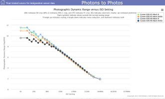

In terms of dynamic range, only the EOS 5D Mark IV is close to the EOS R5 Mark II, with around a .5 EV gain in using the EOS R5 Mark II over the 5D Mark IV. But if you shoot any sort of video the advantages of the readout speed are decidedly in favor of the EOS R5 Mark II. If you are using any other version of the 5D, it's time.
Canon EOS R5 vs Canon EOS R5 Mark II
Both are amazing cameras. We will bypass talking about the AF changes, the better heat management, the improved video features, and eye control focus – all of these factors make it a camera that EOS R5 users can upgrade to.
But most importantly for those EOS R5 users, the image quality has to be excellent and competitive for them to upgrade. It's a mixed bag if you are coming from the EOS R5, but I believe the sensor's advantages outweigh the minor negatives.
There is a price to pay when you have the need for speed. Noise and thus, dynamic range suffers slightly with the EOS R5 Mark II as compared to the EOS R5.
The EOS R5 Mark II using a mechanical shutter is a little more noisy and shows less DR than the EOS R5 does. But in terms of absolute numbers, this amounts to .4EV less than the EOS R5. That dynamic range difference is only until the second gain at around ISO 500, and after that, the performance is pretty much equal between the two cameras.
So if you find yourself shooting in higher ISO's then the difference is negligible. If you are a landscaper shooter who lives under ISO 200, then you will have to judge if the loss of DR is that important to you.
Now if we look at the electronic shutter operation, we see that the EOS R5 Mark II is better than the EOS R5 by nearly the same margin of .5 EV, most likely due to the fact that the EOS R5 Mark II supports 14-bit raws with the electronic shutter, while the EOS R5 only supports 12-bit. Again, after ISO 500, the two cameras are pretty much the same.
Now consider the speed difference of the sensors, which allows for a far better electronic shutter without artifacts and at the same time, an increased dynamic range. It's pretty significant what Canon has done in 1 generation there with nearly a 10-fold performance increase and a minor amount more noise than the prior generation of sensors.

When set at the lowest ISO on the Z8 it matches the dynamic range of the R5 Mark II at ISO 100 and is nearly 1 full EV behind the EOS R5 Mark II at ISO 100. It's not until the dual gain of the sensors takes over at ISO 500 for both sensors, the difference is extremely minor.
Now to be fair, that's comparing the Z 8's fully electronic shutter against the R5 Mark II's mechanical shutter. But here's the rub: there are times you will want that ISO performance from 100 to 400, and having the option for a mechanical shutter isn't a bad thing. It's not Canon's fault that Nikon decided to go fully electronic and not give Nikon users the benefits of a mechanical shutter.
But if we do compare electronic shutters, just so that one particular website doesn't get up in arms over it. We see that at ISO 100 the EOS R5 Mark II still has the advantage, but the Nikon Z 8 pulls slightly ahead because it's able to shoot down to ISO 64. So if you are able to use ISO's lower than 100, then the Z 8 will be slightly better.
From the purist standpoint, the Z 8's sensor has a quicker readout speed and also has undetectable noise reduction in its processing pipeline, while Canon's EOS R5 Mark II still performs some noise reduction in the shadows.
But Canon keeping the mechanical shutter allows the camera to shoot at a higher dynamic range and arguably less noise than the Nikon camera, even though Nikon's choice of sensors is slightly better. What's more important? The sensor or the camera?

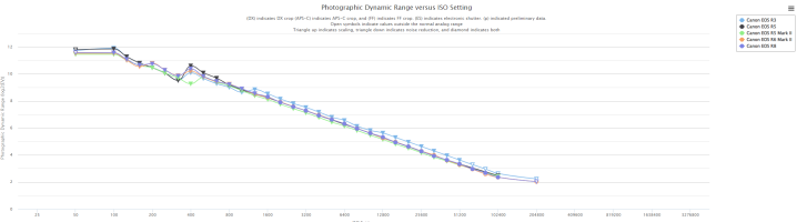

  5. Interesting but I'd like a comparison with the R6 mark ii please
    Here you are: The R6ii looks significantly lower at lowest iso in ES and no difference in mechanical, with the caveats in my last post.
