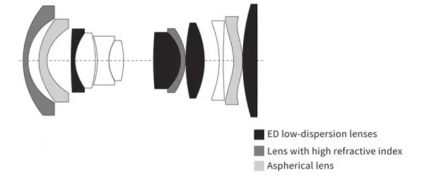

The Viltrox AF 14mm has a sophisticated design for such a small and inexpensive prime. It features 4 ED low dispersion elements, and two elements with high refractive glass in its 12 elements in 9 groups element arrangement. It also sports two aspherical elements to aid with aberrations and resolution. That's an impressive optical design for a $200 lens.

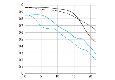

If this MTF is to be believed, then the complex design is doing its job. It's impressive with decent contrast and resolution throughout the frame, without a huge dropoff into the corners. While it may not be the pristine sharpness you'd expect from a Canon L grade or similar lens, it's also only around $200. I'd be thrilled to have this lens on either a full-frame or APS-C camera, and could see using it a lot on both.
To give this a relative comparison feel to it, let's look at it compared to the Canon RF 16mm F2.8's MTF. While the scaling is different along the x-axis, it's clear that the falloff of the blue lines (resolution) and black lines (contrast) is far more than that of the Viltrox lens.
It really is no contest; the only benefit is that the 16mm is a faster lens at F2.8 instead of F4.0, but I doubt the 16mm would clean up enough after stopping down one stop. Also, keep in mind that the RF 16mm F2.8 STM is 50% more expensive at $299.

the fact that the center lp30/mm goes down at F/8 makes me think you are right that they are showing it diffraction corrected.
