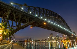

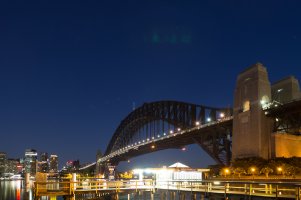

I have a new camera and new lens photographing an old subject matter. Since the new camera+lens (Canon 6D and Canon 24-105 f4 L) I have been getting a green ghost image(s). Does anyone know what this is and how to avoid it?
It looks like internal reflections of the really bright lights on the bridge and the wharf.
On this photo are two examples of the problem:
- Top centre green boxes (5)
- Centre centre green dots (7) that appear just above the bridges arch
Any and all help appreciated.

These are reflections, could be internal...

You mention other images that have this, can you show them?  It does look like some sort of internal lens reflection.  Those bright lights below the bridge are pointing right at you, and its obviously a long exposure, so even a very minimal reflection will show up.

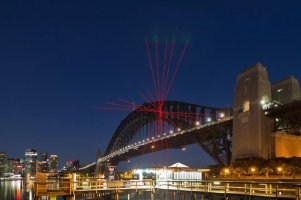

Agreed, definitely reflections.  If you use this image and the drawn centre by Arjay, you will find less obvious (fainter) reflections of the lights as well.  They are not stars as they are stationary and not starting to have a trail like the few stars you can see.
These happen with most lenses when pointed towards or at a bright light source.  Night photography makes them far more obvious because the bright light reflection(s) inevitably end up on a dark sky.  Sometimes you just cannot avoid them.
To fix, I use Lightroom to spot heal where I can.

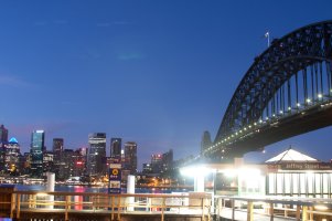

Mr Spokane Photography - two examples one is with 6D from another angle and other with 40D similar position.
Note these are not long exposures (10-15sec) so no star trails etc.
